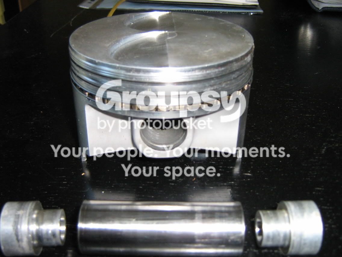

These are 94mm forged slipper skirt pistons with notches to clear valves. They are the only piston to use in a big HP turbo engine. Mahle are not strong enough.
