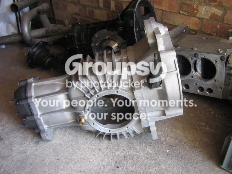

This is the gearbox I hope to eventually build and put in Bugster.

It takes a Ford 9 inch R&P and I have a spool for it too. The gear sets are VW so that bit is easy. The R&P is about 50% bigger than a T1.

The engine block behind is from Pauter, but it's not mine, and will be in Poland soon.
The axles on the Mendeola gearbox are normal VW.

czy ta skrzynka bedzie miala wlasny obieg oleju :roll:

The gearbox does not have a special oiling system as it's for Drag racing and not for circuit racing. The main advantage is the size and strength of the Ford R&P as they are reliably used in V8 powered cars making thousands of hp and the standard R&P in VW gearboxes usually only lasts about 5 hard passes before being junk.
