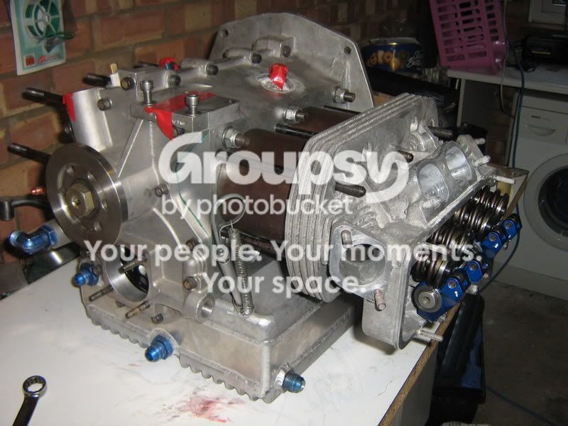

Chris - is this one of those 3 piece case (scat maybe?) engine with t4 main bearings and wide spaced studs that allows to run v8 pistons? kool.
31 sierpnia 2006, 12:46
Yes, it is a 3 piece case, but not from Scat. It is from Bugpack and was used, as was the whole engine, in Holland. It has undergone some modifications in my hands.
As far as running a turbo- maybe some time in the future. It has been a long time since I drove anything this fast and I'll need a season to get used to running 10s.

The cost of the engine wasn't too bad as I bought it from a friend and I am the third owner of it.
I will post some pictures of it later, but it is almost finished. I am putting the pistons and cylinders together at the moment, but it's a tight fit as the pistons are 101.6mm and there is not much space.
I chose a T1 based engine rather than a V6 because it still looks like a Beetle engine and is easy to repair if something goes wrong. I have some experience of the VW V6 engine and it is difficult to repair because of things like oversize bearings not being available. A Beetle engine is also much lighter and this is important in a light car where the weight is mostly at the back anyway.

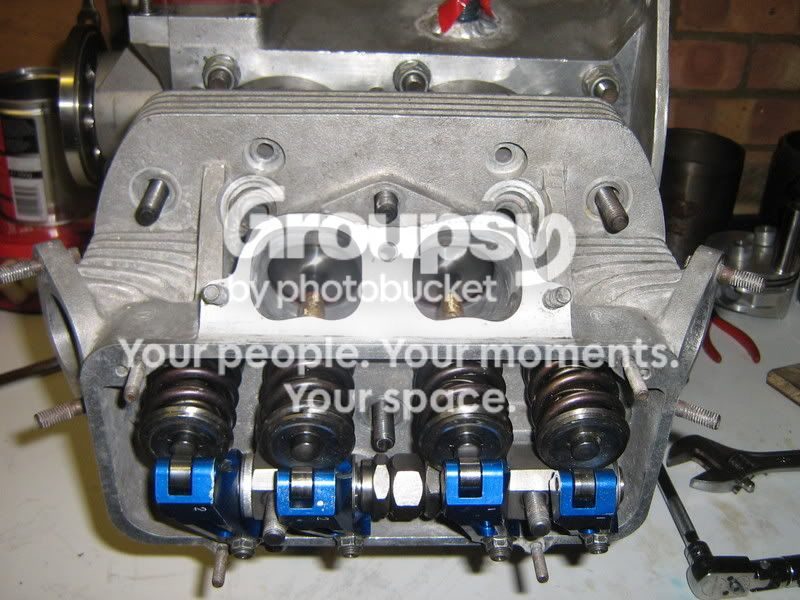

Uau, dolot naprawde robi wrazenie. Ta glowica chyba naprawde dobrze "oddycha" ;) *
Angle flow?
Ladne klawiatury.
Ladne zeberka na cylindrach
Podoba mi sie sprezynka przy bagnecie oleju. Jesli naprawde jest potrzebna - duzo mowi o silniku :)
