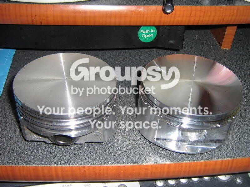

The piston on the left is a Keith Black 96mm and the one on the right is a JE 103 forged piston to be used in an engine I am building for a customer in Poland.
